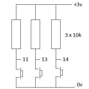

For this one you need 3 buttons
Up on pin 11
Left on pin 13
Right on pin 14

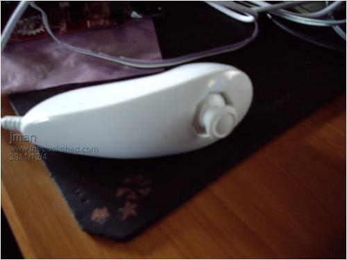

Hi
I added the Wii numchuck code
So now i can play this with my $3.50 numchuck
All the wii variables are still there so maybe somebody wants to make it
go with the accelerometer
Jman

  VK6MRG said   Could someone design a game controller interface for the Maximite?
We allready have one take a look at this post
NumChuck
Jman
