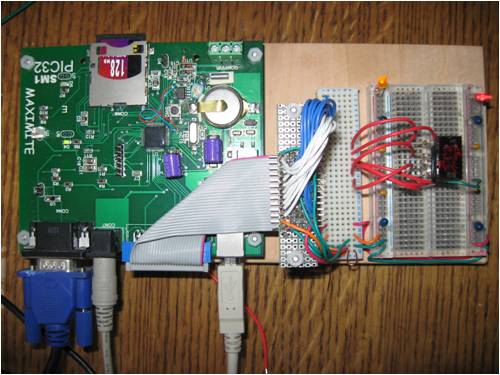

My main interest in the Maximite is as an electronics prototyping tool. I have been searching for a convenient platform for initially playing with IC Chips and Sensors. Most chips have I2C or SPI or other digital I/O and it's very convenient to have a system that lets you plug in a part, write a bit of code to tickle and read it's inputs and outputs and display the results withut resorting to assembly language and logic analyzers, etc.
Below are a few pictures of the setup that I made for the Dontronics SM1 but its applicable to any of the brothers or cousins of the Maximite discussed here.
Photo 1 is a overview with the SM1 on the left, a cable to a sort of breakout board, a first small breadboard and a second main breadboard. The first breadboard is a small breadboard cut in half. It is used to bring the wires from the breakout board down where they can be used. This board is numbered and I made the pin numbers on the BB line up with the MM pins- 1-20. I used different wire color for the 1-10 as for 11-20 as a reminder of the 3v/5v limits.

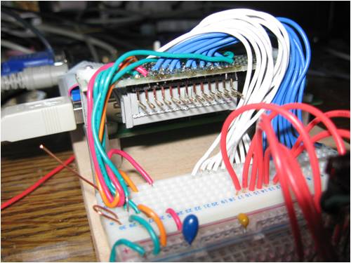

Photo2 is a closeup to give a little detail on the breakout board. It's just a piece of copper clad perf board with a double row header to take the ribbon from the SM1 and some right angle pin strips to give a convenient test point for a logic analyzer or scope. (not really necessary but something that I did earlier)

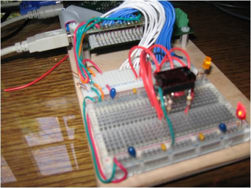

Photo 3 gives a view of how its is used. On the breadboard section is a seven segment LED display, supported by dropping resistors that I have connected to pins 11-17 in 5v open drain mode (mode 9). I was quickly able to write a little basic program to put numbers up, etc and play around a bit. Also in this photo, you can see an orange and red led- these are conected with (dropping resistors) to the 3.3 and 5v busses from the MM and give you a bit of confidence that things are connected.
What I like about the system is that its simple and keeps me from miscounting pins on the 26 pin connector, etc. I think the labelling could be improved a bit to let me know what special pin functions are (i2c, serial, counters) but it serves my needs pretty well.

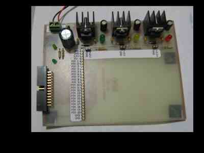

Here is my home brew version of a prototyping board, single sided pcb.
The blank area will have a breadboard as soon as I can get one, there is only two jumpers on the whole board.

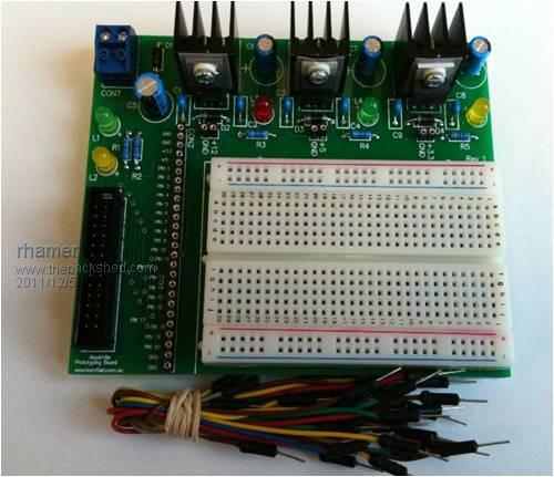

  centrex said   Here is my home brew version of a prototyping board, single sided pcb.
At least some acknowledgement of what you copied would have been nice.

My apologies to Rohan, but I did say it was a homebrew version.
It is a visual copy but thats about it, it is single sided with the pinout that follows the MaxiMite pinout exactly.
The board only requires 2 jumpers in the power supply section.
regardsEdited by centrex 2011-12-07
