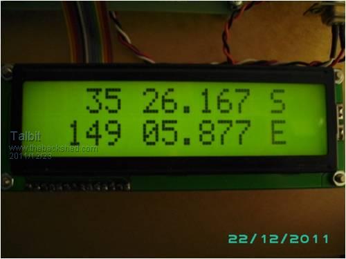

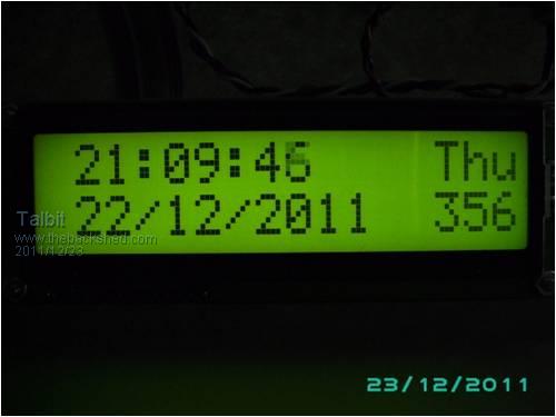

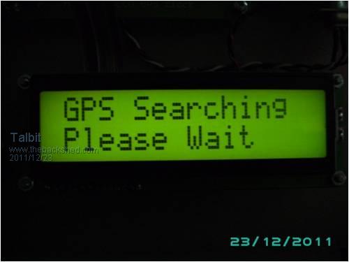

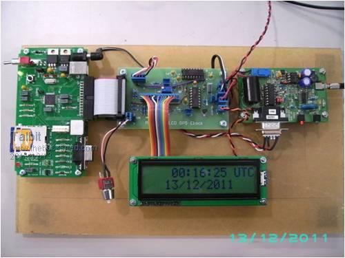

This is the latest version of my GPS Clock. Please refer to my original post on 26 September for more info on the concept.
The main improvement is the addition of a push button which gives a display of the position.
The clock uses a Trimble ACE 3 module set to deliver the NMEA string at 19200, 8, N, 1.
The LCD routine is unchanged from Geoff's original code. It also uses his parsing code to extract the relevant information from the NMEA string.
Thanks to all who contributed help on my code hang-ups!
I’ve also attached a circuit diagram and have built the PCB.
It works like a charm.
Not that the Alarm (Time Break) now appears on pin 2 and not 18 as in the original design.
Pin 18 now controls the PPS LED. It only enables the LED when there is a valid GPS time and position fix.
Please post any suggestions or comments.

Thanks to tassyjim's very smart code to extract the day of the week and the day of the year, I've been able to add these features to my GPS clock.
It now gives this display...
12:05:37 Tue
20/12/2011 354
and the Latitude and Longitude when you press the button.
I'll test it for a few days then post the code.
Thank you Tassyjim !!!

I only used the Trimble because I had a few left over from a job at work – so basically they were free! Actually, I think mine might be an ACE2. I’d have to look closer, i.e. pull it apart to check. Sorry – my fault. But the ACE3 isn’t all that different I think. My unit also rides on another board we made at work. It has a 5 volt switching regulator on board and it also stretches the PPS from a 10us pulse to around 10ms so that you and the MM can see it. It also has a MAX202 chip on board – i.e. an RS232 converter.
The Trimble also requires some software to tell it what to do. You can’t just get into it with HyperTerminal or similar. But the software is freely available.
Anyway, all that aside, you can use any GPS unit that gives serial NMEA out at a respectable rate. I think all give the $GPRMC as default. I’ve programmed the Trimble to give just that at 19200, 8, N, 1.
For my program to work you must also have the Pulse Per Second out. This is the only thing that you can really reference anything to. I recon the NMEA strings might actually appear at slightly different times so you can’t use that as an accurate reference. There are stand-alone Garmin GPS units that are easier to use and also provide the PPS. The unit Geoff used in his Car and Boat Computer uses the EM-408 and is a great unit but it doesn’t give you the PPS. No matter what unit you use, you need to check whether the NMEA string needs to be inverted, the PPS needs to be stretched and inverted and whether you can program them.
But I can see where you are coming from. Geoff’s car computer provides the position data via the USB and indeed it is designed to run with OziExplorer. But his clock display is about 250ms late.
I’m not sure if the sub $100 car navigators will give the PPS. I’d be surprised if they gave you the raw NMEA string.
Have a look at the Silicon Chip March 2007. Here Jim Rowe uses a Garmin 15L unit and the PPS as a reference for a 10MHz oscillator. He also extracts the NMEA string, decodes it and displays the time on the LCD. Unfortunately, he doesn’t link the time display to the PPS so the time is about 250ms late too. There are also a number of bugs in his software - which is assembler.
The Garmins were available from Johnny Appleseed http://www.ja-gps.com.au/
But I’ve just looked on their site and they are not listed. Give them a call.
Anyway, let me know what you come up with. Hopefully, I might have inspired other people to look into different ways of building an accurate clock.

Here you go, just in time for Christmas !!!
The new code gives UTC Time, Date, Position, Day of Year and Day of Week. Also a couple of happy snaps to show the three readouts.
Thanks to Geoff Graham and Tassyjim.
Talbit
Merry Christmas.
ps Now you know where I live!
10 '''''' GPS Clock 21st December 2011 By Trevor Dalziell ''''''''
20 '''''' with Time, Date, Position, Day of Year and Day of Week '''
25 '''''' with thanks to Geoff Graham and Jim Hiley ''''''''''''''''
30 GOSUB 11000 ' Initialise the LCD
40 GOSUB 2000 ' Set all I/O pins
50 PB=1 ' LCD display of Time (Push Button=1) or Position (Push Button=0)
60 ''' Parse the NMEA string from the GPS by Geoff Graham ''''''''''''''''''
70 '
100 max = 20 ' Maximum nbr of params
110 '
120 DIM arg$(max) ' used to hold the data items
130 OPEN "COM2:19200" AS #1 ' Pin 19 is COM2 Rx (NMEA)
140 '
200 DO ' loop forever
210 GOSUB 500 ' get the next line
220 IF arg$(0) = "GPRMC" THEN ' GPRMC contains GPS Time
230 IF arg$(2) = "A" THEN ' A means locked on to satellites
240 GOSUB 4000 ' Extract the Time, Date, Lat & Long
250 ELSE
260 PIN(18)=0 ' Switch off PPS LED
270 LCD_line1$ = " GPS Searching "
280 LCD_line2$ = " Please Wait "
290 GOSUB 12000 ' Send message to LCD
300 ENDIF
310 ENDIF
320 IF arg$(2) <> "A" THEN 210 ' Not locked on to satellites
330 PIN(18)=1 ' Switch on PPS LED
