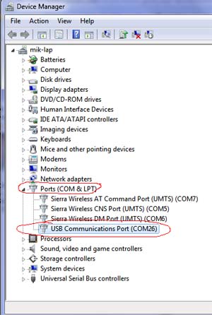

Hi Bob,
Maybe COM3 is used as an internal device....
Try setting to a port thats higher (mine sets to com26)
Go into Control Panel --- Device Manager ---- Ports ----
Do Properties on the relevent USB COmmunication Port and click advanced and select a port that it says is available (i.e. NOT in USE)

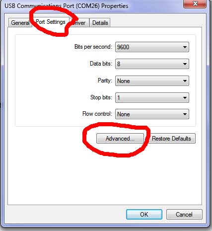

Hi Bob,
I do Indeed have WIn 7, home Premium, 3 systems running it.
I did skip a couple of steps though... sorry
when you see the list of ports as in this picture
Then right click on the port Number to get properties and click the key card tab to select Port Settings as shown,
The port settings are there and the advanced tab near the bottom
Hope this helps you

when you put it in pictures then yes we do see the same thing. I did not interpret your explanation the way that you intended.
Many ports not listed as in your first image were In Use and unavailable. Finding available ports was trial and error, mostly error. Any available ones I tried did not work.
Bob

Sorry , My fault it is hard to put into words steps that you did earlier and the screen

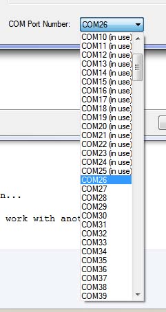

Ok, Bob,
When I select a port to assign, Using advanced TAB under port settings, I get the following and it lists all available Port No's I can use
If you selected one that doesnt say `in Use' then sorry, I have no idea what it could be then...

Ok, we did see the same thing but none of the ports in my list were showing as (in use) so that confused me. Anyway, I just forced a port change to 16 and now I get complaints from the system that the port can't be installed. I'll reboot and try again.
