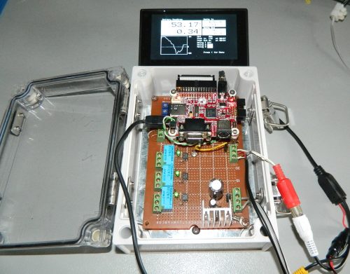

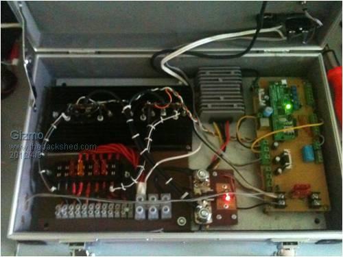

OK, this is a project I've been putting off too long, time to get it finished.
I've built a few PicAxe based charge controllers in the past. One was a 28X based controller with LCD http://www.thebackshed.com/Windmill/articles/GizmoPicAxeChar ger.asp, and is still in use. The other used a 08M and was designed more for logging, but could be used as a controller http://www.thebackshed.com/Windmill/PicLog.asp. As soon as I first saw the Maximite early this year, I knew it would be the brains behind a more advanced controller. I wanted a controller that would regulate my battery bank, by controlling the solar/wind turbine supply, and track watt hours in and out of the battery bank, so I could tell at the end of the day if my batteries were gaining or loosing charge, and take action if needed.
This is it so far.

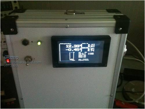

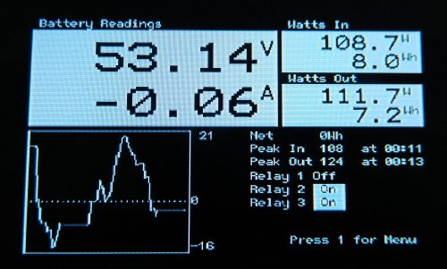

And a shot off the normal screen,

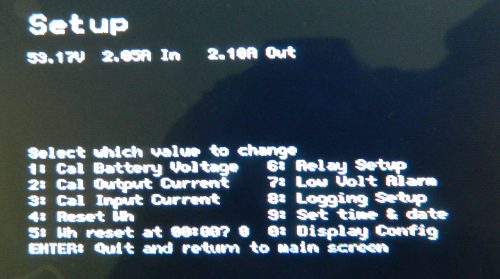

And the menu screen.
The controller monitors battery voltage, battery current in and battery current out. From this it calculates the watts and watt hours flowing into and out of the battery bank. It displays the battery voltage, net current, watts and watt hours into the battery, watts and watt hours out of the battery, net watt hours, and peaks. There is also a running graph of the last 2 minutes of net battery watts. The graph is updated every second, while the rest of the display is updated 4 times a second. The controller has 3 independently set relay outputs for operating diversion/dump loads or shutting down a windmill. Plus there is a low battery alarm and data logging to the SD card in intervals of either 1 minute, 1 hour or daily.
Its based on a DuinoMite-mini, though could use any of the Maximite series. Display is a little 4.5inch LCD monitor.
It's a work in progress, I'll post more soon.
GlennEdited by Gizmo 2011-12-23

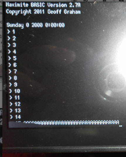

  Gizmo said   Hi Bryan
The little screen I have is PAL, so the Maximite runs in 304X216 pixel mode, meaning screen space is tight. But thats OK, the text is so small anyway that from 1 meter away my old eyes cant read it Thats why I've used larger fonts for the critical numbers and reverse video for the relay states.
Glenn, I have the same screen as you, and you are using a DuinoMite-Mini.
If you haven't done so already, can you try setting it to NTSC-480 in the "setup" menu and see what happens.
Cheers Don...

Tried the NTSC-480 mode, looks good and gives some more pixels across the screen I could use. But as I plan to put this project together as an article for the main web site, I want to keep it compatible with all the Maximite range, maybe later when its finished and I can modify it for my own use only.

Fortunately this project is only using 6 of the Maximite IO pins, pins 1 to 6, and these dont conflict with the other accessories ( SD Card, etc ). At a later date I may look at adding more functions, like battery temp, etc, but until then, 6 pins is enough.
The ciruit is pretty basic. 3 pins are for the relays, driven though a opto-coupler. You see, I have a pile of old computer boards, so tend to design my circuits to use components I can salvage form those boards. In this case, I'm using the opto-coupler driven relay circuits as used on these old boards, but a transistor driven relay, or a directly driven reed relay could work just as well.
For the inputs I'm still undecided. Voltage is easy, a resistor divider, plus protection diodes for the Maximite input. Current, not 100% sure on what path yet, but looking at using a couple of op-amps and shunt resistor combination. The shunt resistor will be a length of steel thread, used this type of setup before and its works well. Still we only get like 0.1 volts per 100 amps, so a op-amp set up with a gain of 30 would be needed. Geoff mentions a OPA251 for precise low voltages, but Jaycar dont list them, so might look at alternatives, any suggestions?
Or I may go for a current transducer or a hall sensor like the Alegro sensors. These get a little more expensive, and are bi-directional so will need a off-set implemented in the software.
Other than that there is a 5v regulator, and thats it as far as circuits go.

I received a badly manufactured screen, see bottom left hand corner. This is running on a DuinoMite-Mega in NTSC-480 mode.
Just sent him this image, see how I get on with a replacement.
Pay your money, take your chances.

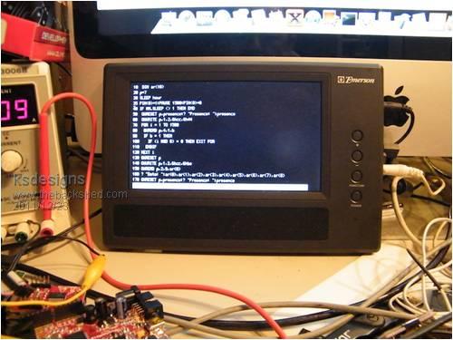

I use one from a car dvd player the kind that go on the back's of the seats
got a few of them at a thrift store for like 10$ and were new also :)
plus they have audio
ken

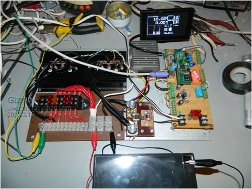

Had a chat to Pete (downwind) tonight about the current sensing side of things, and he suggested I look at the Alegro ACS758 series of sensors chips in the unidirectional range. These will measure current in one direction only, so we get an improved resolution, 0 - 5 volt for 0 to max current instead of 2.5 - 5 volt for the bi-directional chips. Also the bi-directional chips can be a bugger to zero, the 2.5 volt mid point is dependant on the 5 volt supply, any drift in the supply and you can be reading plus or minus a few hundred milliamps.
I've ordered a 100 amp and 200 amp chip. The 100 amp chip means I can measure up to 5kw input power to the batteries, and the 200 amp chip will let me measure up to 10kw drain, based on a 50 volt battery bank.
I've been working on the software. Changed the running graph to display either the last 120 seconds, 120 minutes, or 120 hours ( 5 days ). I dont want to post the code just yet, its very messy and I'm still adding features. But as soon as its done and the controller is working I'll post it.
