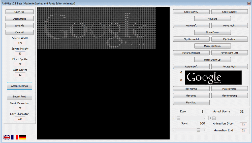

I made a little Sprites and Fonts Editor Animator for the Maximite.
Because the dll's needs from VB6 i have do it in Delphi who
work directly on the 3 PC i have here.
Test it and tell me if you found some bugs.
Cheer.

The new version accept ONLY *.bmp pictures ! , only black and white pixels
are decoded.
Also convert your pictures in B&W before you use the Animite.
Here one example i do for testing ...
and here ... the new version from the soft :
2012-01-09_005624_Animite.zip
Enjoy.
