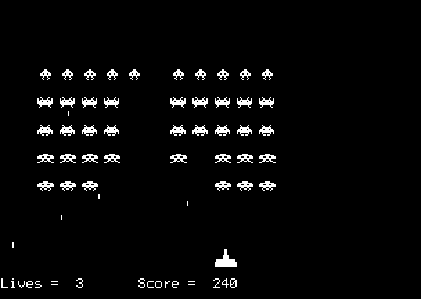

Hi ,
This morning i have want some fun ,
then i program me a little Space Invaders
No Mistery ship and Bunkers atm .. but it's playable.

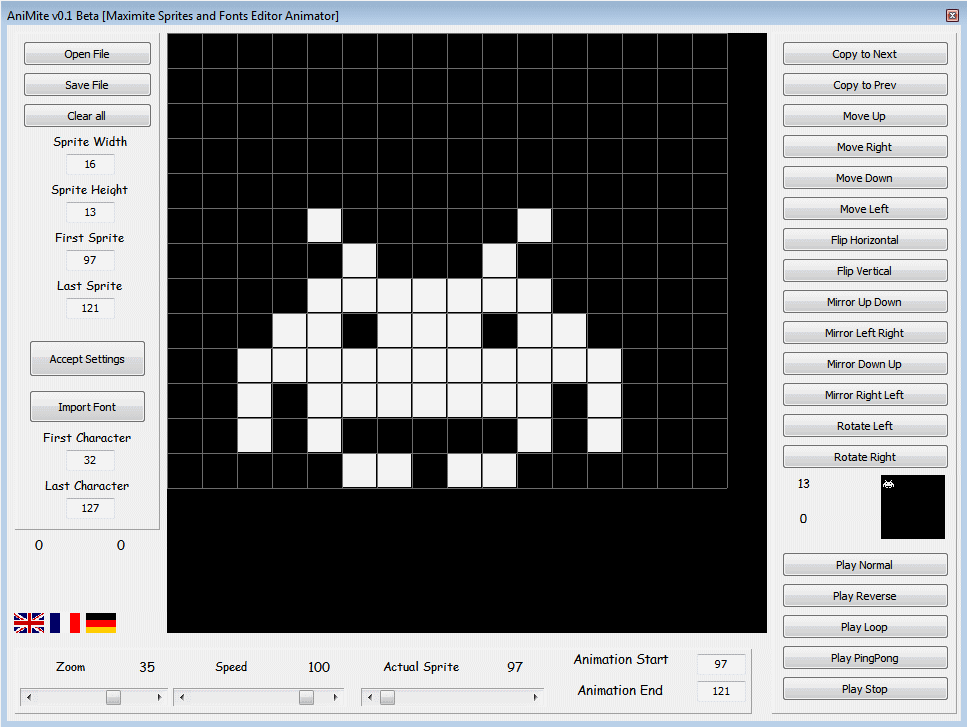

I have use AniMite to create the Invaders sprites.
they are 3 buttons:
PIN 13 : Left
PIN 14 : Right
PIN 15 : Fire
Enjoy

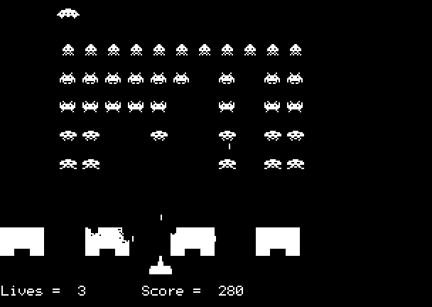

I made all other needed improvements.
bunkers are here , and the menu screen is
most like the original one
2012-01-03_075258_Invaders.zip

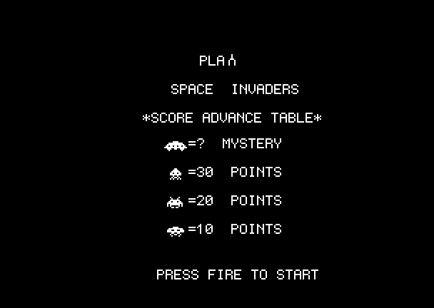

also I noted that the invader on the start screen comes out 1 line above where the upside down 'Y' in PLAY is. This is intentional? If so ignore my fix..
if not I changed the code on lines
6200 Line (px1 , 38) - (px2 , 49) , 0 , BF
6210 pause 5
6220 locate AnimX , 38 : print CHR$(Spr);
Changed 38 to 50 and 49 to 61

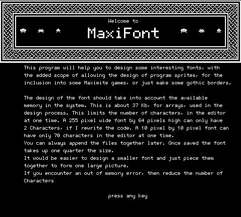

I wrote a Font editor, Called it 'MaxiFont' that I have sent to Geoff, for the library. So if you want, you can pick my programming errors..
Link to MaxiFont http://members.iinet.net.au/~dpwyatt/MAXIFONT.zip
I too created an invade.fnt
As I said before, great implementation, well done

Animite
for the change on the line 6200 to 6750 it can be that we
get a difference between Composite PAL and VGA.
Here i use the PAL connection to the TV.
For the variable to use the KB , just do it , it's free to all to modify
and made it better.
Cheers.
Darth.

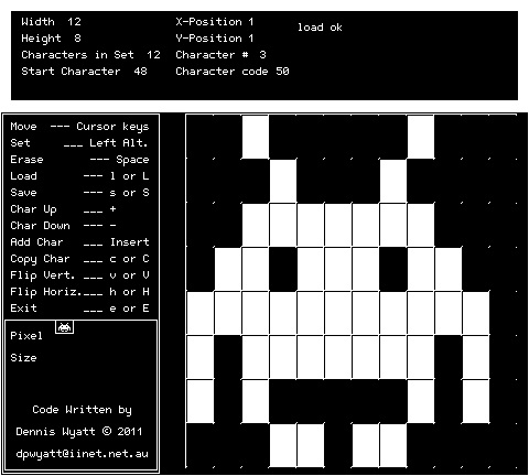

MM_Wombat
Joined: 12/12/2011
Posts: 139
Posted: 01:24pm 03 Jan 2012
I haven't actually seen this editor before, but it looks awesome.
My font editor is written on the maximite for the maximite..
Screen 1
screen 2
But yours looks better( color )
Hasn't been tested on a composite display....
Edited by MM_Wombat 2012-01-04

I have found why it was different in start screen between composite
video and VGA.
That was just the 'Press fire to start' who was to low on screen and
then moved everything up ;)
So ... enough babbling ... here it is ...
