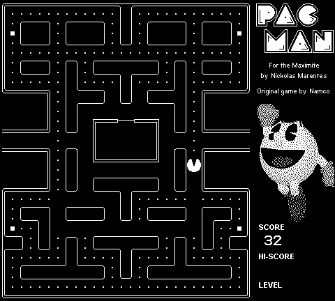

In another subject thread, I asked about whether there was a standard for joystick control on the Maximite. The reason for this was regarding the problems with keyboard control when using INKEY$ in a real-time arcade game application.
The problem arises due to the Maximite's use of a keyboard repeat delay and repeat rate. This gives an inconsistent reading if the game requires movement control as a key is being pressed. The key doesn't always deliver the key value, reseting to zero as it pulses to the repeat rate.
I have begun writing a version of arcade PACMAN for the Maximite and this was a problem due to the nature of the 4-way keyboard controls in PACMAN.
I therefore considered writing it for joystick but I knew it would alienate many users from being able to play the game.
I gave it some more thought and have adapted the keyboard logic to compensate for this and succeeded.
Below is an image of what I have done so far. The PACMAN character can navigate all around the maze and eat all the dots. The speed and animation (mouth chomping) is just like the original arcade game and the use of an interrupt holds the game at a consistent speed.
The game is fast enough so that if I turn off the speed control, the PACMAN moves around the maze as a blur, indicating there is plenty of time left to add the 4 ghosts on the screen and keep a speed that is very close to the original and operating just as smoothly.
This is a work-in-progress and I will keep this subject thread up-to-date with my progress.

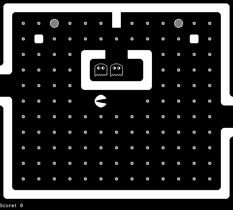

You are going to beat me to it too, I stopped to write BASIC addons and have left my 70% done pacman lay dormant for weeks :-)
This is an old screen shot, it's come a long way since and a ghost is slowly learning to chase me around with sound effects.

Actually it looks likes this! Yes I intended to have different levels with the possibility of going to another screen when you exit left or right :-)
Data 73,71,71,71,71,71,71,70,71,71,71,71,71,71,74
Data 72,81,83,81,81,81,81,77,81,81,81,81,83,81,72
Data 72,81,78,80,81,81,81,81,81,81,81,78,80,81,72
Data 72,81,81,81,81,73,80,84,78,74,81,81,81,81,72
Data 75,81,78,74,81,72,53,65,56,72,81,82,81,81,72
Data 52,81,81,72,81,76,71,71,71,75,81,81,82,81,72
Data 74,81,81,72,81,81,81,32,81,81,81,81,81,81,76
Data 72,81,73,69,71,71,71,71,71,71,71,74,81,81,52
Data 72,81,72,81,81,81,81,81,81,81,81,72,81,81,73
Data 72,81,77,81,82,81,82,81,82,81,81,77,81,83,72
Data 72,81,81,81,81,82,83,82,81,82,81,81,81,81,72
Data 72,81,81,81,81,81,81,81,81,81,81,81,81,81,72
Data 76,71,71,71,71,71,71,71,71,71,71,71,71,71,75]

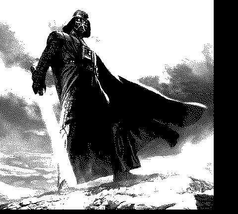

Hi just made a little test ...
I can load and show a full screen in VGA resolution in 2.159 sec
here is the code :
Cls
Timer = 0
Font Load "Darth.fnt" As #6
Font #6
Print @(0,0) Chr$(33) @(255,0) Chr$(34)
Print @(0,63) Chr$(35) @(255,63) Chr$(36)
Print @(0,126) Chr$(37) @(255,126) Chr$(38)
Print @(0,189) Chr$(39) @(255,189) Chr$(40)
Print @(0,252) Chr$(41) @(255,252) Chr$(42)
Print @(0,315) Chr$(43) @(255,315) Chr$(44)
Print @(0,378) Chr$(45) @(255,378) Chr$(46)
a = Timer
key:
k$ = Inkey$
If k$ = "" Then GoTo key
here is the source image and the font made with animite.
2012-01-31_064142_Darth.zip
for see the time needed in millisecont just enter : print a
Cheers.
Darth.

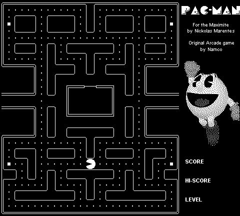

Today's update includes a few minor "cosmetic" changes to the graphics, mainly the title text.
I have it now accurately keeping track and registering all 244 pellets being "eaten" (240 normal, 4 power pellets).
The warp tubes at the left and right side of the game screen operate and the score indicator is functioning. I have set the pellets to only score 1 point so as to act as a pellet counter for testing purposes.
Have been running around the maze checking the keyboard response and looking for bugs. So far, so good. Speed is good but will later provide speed enhancements by changing some of the goto's to labels.
Just about ready for the next big challenge, the 4 ghosts!!
