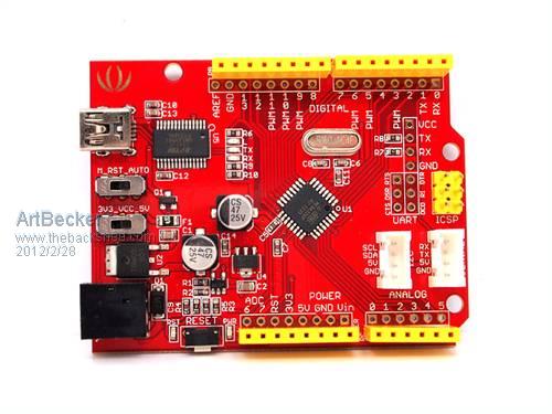

Seeed Studio also makes an excellent Duemilanove, with several improvements over the basic version. It is cheap at US$22.50, with free shipping for orders over $50. I have bought a lot of stuff from them, including the colorful Seeeduino, with no problems.
http://www.seeedstudio.com/depot/seeeduino-v30-atmega-328p-p -669.html?cPath=132_133
The Seeduino uses the same white connectors as their Grove system, which I also have. There are adapter cables between the Grove type connectors and the standard ones.
I also got the last Wii Nunchuck adapter they had, but plenty of other places sell them. It's worth an hour or so to look over all the items they offer.

My thought is that it's a very limited board, so little RAM :(
I like the sound of the F4 board!
Will it only be SWD? Or JTAG?

Is a nice looking board (prettier than Olimexino). Which one, it is user's choice. Probably, the price is the main factor for many.

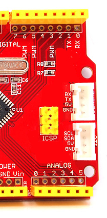

My suggestion regarding to Seeeduino design:
The Grove connectors must be angled (as is on Olimexino), to permit shielding same time. Even more because they already use it on Grove shield:

I confirm seeduino is better designed that arduino, just missing lipo charger, low power LDOs and dc/dc to have same functionality as olimexino

"The Grove connectors must be angled (as is on Olimexino), to permit shielding same time. Even more because they already use it on Grove shield:"
That is a good idea, though you should have been more clear that you Photo-Shopped the Seeeduino in your photo.
Seeed Studio sells a package of 10 angled (or straight) Grove connectors for 99 cents, so at least the serial connector can be changed. In any event, the connectors only duplicate pins, and don't replace them. Conceivably, many users don't use shields anyhow.
However, even if both Grove connectors are populated, you can still install a shield, with just a very small (insignificant) gap at the pin 5 end of the analog connector. The digital and power connectors fit perfectly flush, and all the analog connectors make good contact, due to the long pins used by shields.

  ArtBecker said  That is a good idea, though you should have been more clear that you Photo-Shopped the Seeeduino in your photo.
He he, don't tell me you searched for it in Seeedstudio shop! Sorry, you are right!

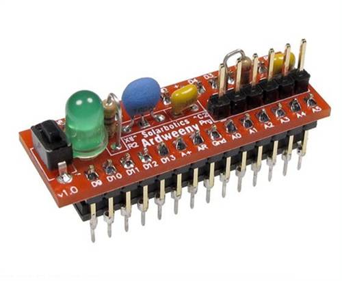

The Ardweeny might be the smallest, and cheapest, Duemilanove version, at under $10, plus shipping.
Ardweeny at Maker Shed
It requires either an external USB-to-TTL FTDI-type cable or adapter, or else you just program the chip in an Arduino Uno (selecting the Duemilanove w/328 option in the IDE, since the Ardweeny 328's Duemilanove bootloader isn't compatible with the Uno or Uno R3 bootloader).
