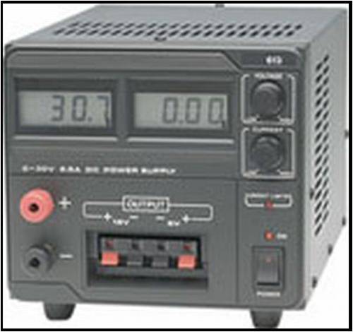

I looked up your Manson supply. All I can say is wow. I found it for sale at about 80 EUR. Here is the manual for it and a picture.
If I was doing what you are doing and had the Manson, I would use the Manson as the breadboard supply as its adjustable supply has adjustable current limiting also. This leaves the question of how to power the MM.
Altronics offer the plug pack M9237A and Jaycar offer this plug pack MP3310 . I prefer (and use) the Altronics one as it is more foolproof. The Jaycar one is multi voltage and if used incorrectly could cause trouble.
From the Manson manual:

  BobD said   Greg
The grounding of the output terminals is independent so that the output
can be connected in series to make a higher output voltage.
Having said all that I am going to leave your questions to Mick.
Bob
