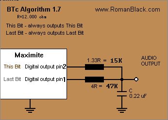

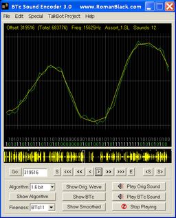

I tried the excellent BTC Sound Encoder 3.0 software
free on site http://www.romanblack.com/picsound.htm
I used 1.7 because the algorithm 'is the best
speed on Maximite.
See BTC Sound Compression Algorithm http://www.romanblack.com/btc_alg.htm
I used two resistors and a capacitor to pins 1 and 2 of Maximite. Something feels ....
I could put a LM358 to increase the volume.
Examples:
10 ' Playback sound with BTC encoder 1.7 - PIU' VELOCE
12 ' New Bit Pin -> resistor value 1.33R -> is always output = 15k
14 ' Last Bit Pin -> resistor value 4R -> is always output = 47k

185 pa=0.02
200 Setpin 1,8:Setpin 2,8: ' Pin 1=Last Bit : Pin 2=New Bit

My initial idea was to just play two sounds at once by "swapping" between sounds every period of the sound but I figured that was just going to turn out messy. So then I thought about using PWM (8 bits all set would be 255 clock periods, 10010100 would have been 148 clock periods etc.) and feed it to the piezo somehow. However, this was not going to turn out wonderfully well because I would have needed some sort of timing circuit to turn this into proportional voltage (resistor-capacitor was my idea but I figured it wouldn't be too linear in its response...) and also it was going to have about a 700Hz sample rate for an 8-bit sample! So I figured why not go the whole hog and use it as high-speed serial and just have a DAC?
Raros, your idea above is brilliant . I will try this out when I have some time
