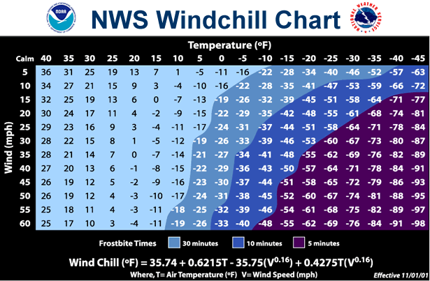

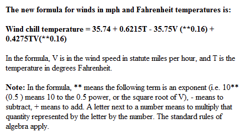

I have been trying to figure out how to enter this formula in MM Basic. It calculates Wind Chill from the temp(F) and wind speed(mph). I have been trying for a couple of days now but my numbers are way off. The part I don't understand is the fractional exponent. Any help would be appreciated.

In MMBasic the exponentiation operator is the ^ character.
So the formula could be written as:
INPUT "Temperature? ", T
INPUT "Wind Speed ? ", V
PRINT CINT(35.74 + 0.6215 * T - 35.75 * V^0.16 + 0.4275 * T * V^0.16)
Interesting chart, although it took me some time to get my head around degrees F and MPH... that was so many years ago. Once I did that I was reassured to see that there is no danger of frostbite in Perth, Western Australia !!
