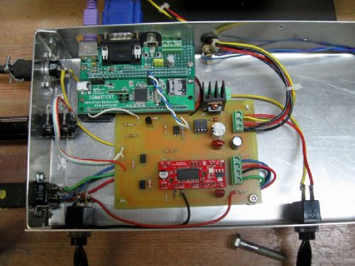

I am using a mini PS2 keyboard so it matches the small monitor size wise, here is what is under the keyboard...
Ron
