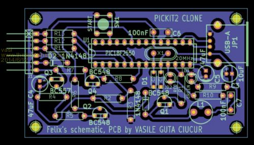

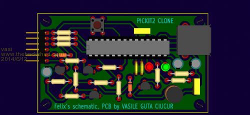

What about a single side DIY PCB in KiCAD?
And the gerber files displayed inside gerbv linux app.
Edited by vasi 2014-06-13
