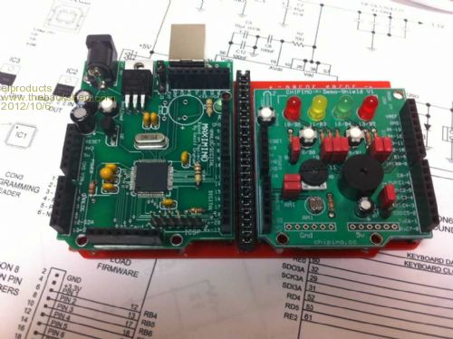

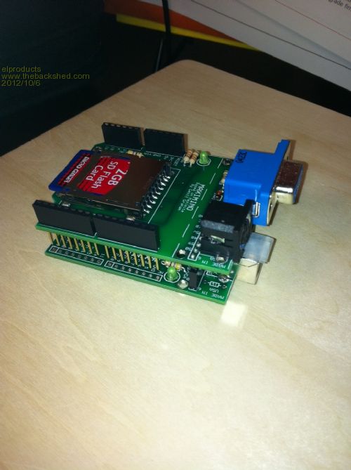

I thought the same thing when the PIC32 DIP parts were released but even before that I produced a few prototypes that I called the Maximino based on the original Maximite to see if there might be interest in this type of module for MMBASIC, but I couldn't get much interest in the thing. I even made a plugin shield for the keyboard, VGA and SD card.
Maybe someday I'll just open source it and let people smarter than me figure it out. It's also where I learned that the Vcap needs to be surface mount to get the required low ESR. Frankly, I hate surface mount for my projects. I'm still old school and prefer leaded everything.

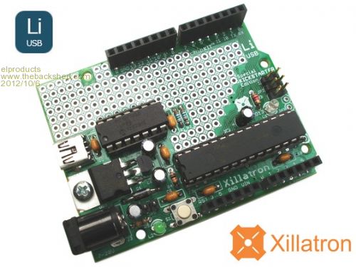

I am guessing here but - the xillatron first photo
seems to have an leaded electrolytic capacitor, and the further
photo seems to have a leaded tag tantalum capacitor instead.
I get the impression they are not the low ESR usually needed ??
The dspic33f at 40 mips certainly need the low esr. Microchip boards
tends to use small format 0805 Murata / Panasonic smd ceramics, I
have settled on the larger size 1206 equivalent which are much easier
to handle,
Murata GRM31CR71A106KA01L
I tried soldering leads onto large kemet tantalum-chip capacitors
and it worked ok, but it was way too fiddly and looked like a
Salvador Dali existentialist installation - maybe there's
money in it yet

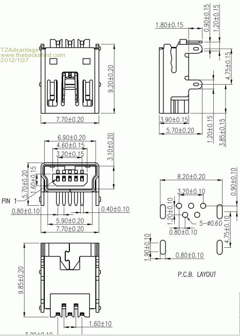

chronic also just pointed out to me that the mini-usb used could be a through hole type. I checked and you can see the pads on the solder side of the board artwork, so they are through hole.
I'll almost bet these won't be easy to get for many users, and the standard BM should have been used. After all, the profile is lower in height than the DC connector.
Don...

Posted: 03:06am 07 Oct 2012
I looked back at his board layout and see that you are right, it is leaded.
I learn something from you guys everyday.
I never knew a leaded version of that mini USB connector existed.
This is great.
Digikey doesn't list any but Mouser has one that they list as a new product.
Details at the link below.
Great catch guys.
I have several designs this can be used in.
Mouser Details on Leaded USB Connector
