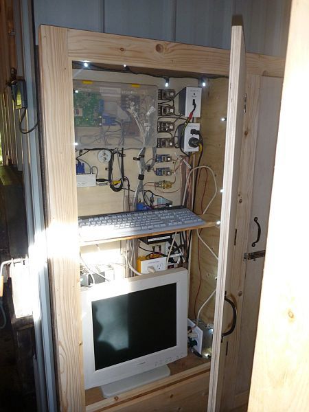

As some may remember I have a MM running a wood-fired boiler. I’m in the first season of real tests using it to heat the house. Things are going pretty well though I did run into an issue yesterday.
When I designed the system I put in a number of 24 volt relays to control line power for various things like line current motors for opening and closing the fire box air intake and running a house fan.
I learned early on in the test phase that in addition to the MM power switch I needed a second separate switch for the 24 volt power supply transformer. This because if the 24 volt power supply is powered on while the MM is booting the 24 volt power goes directly to the 24 volt relays and activates them until the MM takes over control about 3 seconds later. So my start up sequence became, 1) make sure the 24 volt power supply is turned off. 2) boot the MM and about four seconds later, after the MM has taken control of the relays, 3) turn on the 24 volt power supply.
This worked great, until yesterday. I had a rogue reboot of the MM for no apparent reason. The genuine original MM, along with everything else in the system, is powered by a 12 volt DC lead acid battery system which also runs an inverter for line power and a 24 volt power supply. The batteries are charged by a 90 watt solar panel and a Trace 12 volt line charger when there is line power (most of the time). With an uninterruptible power supply system such as this it never occurred to me that the MM would ever reboot on its own.
But it did. And when the MM had its rogue reboot the 24 volt relays were still powered and were activated for about three seconds while the MM was rebooting. This caused the Air Intake motor to rotate for 3 seconds putting it out of alignment leaving the air intake open instead of closed. After rebooting the MM program thought the fire box air intake was closed, but in fact it was open and the fire was merrily burning for over an hour before I noticed on the temperature sensor display that I had about 200 gallons of boiling water. That is about 10 degrees hotter than I like to see. This is not a pressurised boiler system and it really shouldn't be allowed to get up over 95 degrees.
So I’m trying to find a way to automate the delay for the 24 volt power supply while the MM boots, sometimes unattended and by itself. I could have built another relay into the secondary component board. Maybe one that operates on 12 volts with an open circuit default, which could then control and turn on the 24 volt power supply after the MM is up and running, but the component board is full. It’s too late for such a relay on this component board, but maybe I can include a relay like that on the next component board I build for this boiler. It's always good to have spare parts and back-up components.

The MM does monitor the boiler water temp. That is what lets it know when to shut the air intake. But if the air intake was put off its calibration by the motor turning for a few seconds at start up, before the MM took control to keep it from turning, then the MM does not know it is not really closed.
I do have a sort of low tech work around that I’ve been thinking on. During the testing phase last winter I often forgot to turn off the 24 volt transformer before I booted the MM. The result was that the chain that wraps around the air intake motor drum would turn too much during the boot and physically disconnect and tear away from the air intake plate. It would rip the plate up and away from the surface it was supposed to lay flat on when the air intake was closed. I got around this by connecting the chain from the Air intake motor to the air intake plate with a small copper wire link that was only bent over, not twisted to lock it tight. This allowed the chain to pull open the copper “link” if the motor got away from me and ran during a boot up.
You have the scenario correct. The MM crashes and reboots causing the air intake motor to set in an incorrect position. I do have a routine in the program that constantly monitors the boiler water temp, but I only wrote the program to close the Air intake when it thought the Air intake was open. Never thought it would be important to close the Air intake when MM thought it was already closed.
But I’m thinking of putting in another safety sub routine that always checks the water temp (Air intake open or closed) and if it gets say over 95 degrees C then turn the air intake motor three full revolutions in either direction. This would rip the copper link open, causing the air intake plate to fall or drop back down and shut off the air until the system was manually checked on later. Using this method the MM couldn’t reopen the air intake until the copper wire link was reconnected. I kind of like this plan for its safety. I also have a sub routine that monitors the water temp while the air intake is open (and the fire usually increasing). That routine monitors the water temp, and if it continues to go down instead of up, and goes down by more than 5 degrees, then the MM closes the air intake and flashes the message “TEND TO FIRE” meaning that you are either out of fuel or the fire went out. This can happen when the air intake is closed too long between cycles. This happens sometimes when the time between firings is more than six hours.

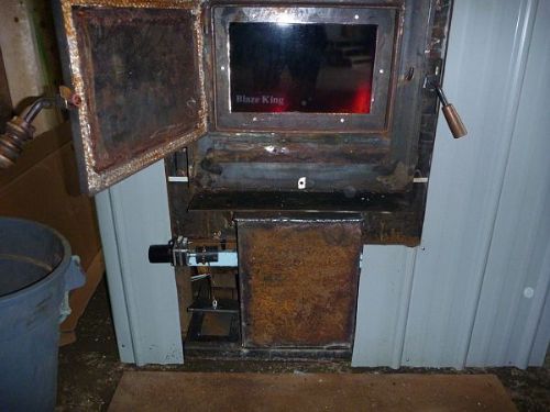

I am using MOSFETS. I mounted them in slot receptacles so I could replace or swap them out if needed. But I don’t know if I can change them for other types of transistors. That is beyond my knowledge or level of understanding at this time.
I like the idea of having a micro switch monitor the actual status of the Air intake plate. I’ll think on that too.
The Air intake is open in the upper photo. Note the plate is lifted by the Air intake motor.
