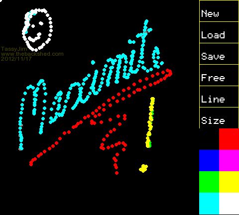

A quick and nasty sketch program to make use of my new touch screen.
My drawing skills are somewhat limited.
(converted from BMP to GIF to upload)
Still needs a lot of work but I am beginning to understand the needs of a touch screen controller.

This is the program.
You will need to uncomment the call to the calibration subroutine and then change the values for Xslope, Xi, Yslope and Yi.
I found that I needed a resistor in series with the Y axis to keep the current draw down. The X axis at 700 ohms was OK as is.
