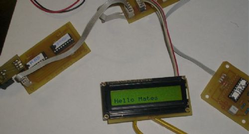

Here is the i2c ps2 keyboard details. Yes, I know ps2 is rapidly dying but some of us have a few of them still and it is easier (I think) to interface to a ps2 keyboard than a USB keyboard.
This module can also read IR remotes (the "standard" type) if the KDB pic RA2 (pin 1) is tied high instead of low. A different arrangement on the kbd input is then required. Not much more than a IR receiver and a resistor.
There should be enough data in the zip file to build one - there's even a picaxe bas file to read the keyboard and display on a 2 line LCD i2c module (That'll be another post).
2012-12-12_063317_New_Compressed_zipped_Folder.zip
