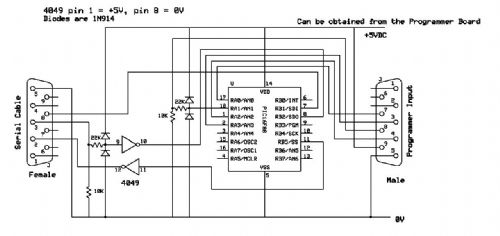

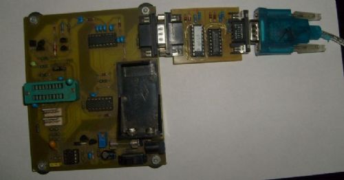

Hi,
I've trawled through many posts and am going cross eyed.
Has anyone here used the SiliconChip pic processor of a few years ago - it used to work using the various RS232 control lines for data and clock. When the comm ports were done away with, using a USB-serial cable either didn't work or was painfully slow.
I don't know whether a hardware upgrade was ever done. In the end, I built a pic/max202 interface that sat between the PC and the pic programmer and chatted away in VB6 RS232 - the USB-serial cable worked quite well then particularly if plugged into an external USB hub (couldn't explain that one) This version uses a 4049 inverter instead of a max202/232 - both work equally well.

Yes I have one of these PIC programmers and I still use it.
It's hooked up to a Windows 98 pc I have, so there's no problem with the com port serial connection. However if my win98 pc ever dies your workaround should prove very useful. thanks!

Ok, I might just go ahead and do an article on the dongle and include the data i/o format and protocol.
Anyone handy with VBasic could write a simple programmer. Mine has a bug or two, but works good enough for me, certainly does most of the midrange 8 bit devices.
