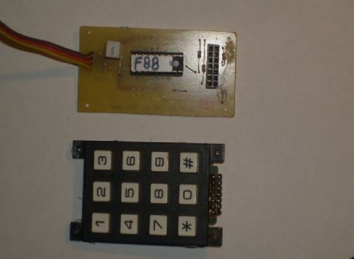

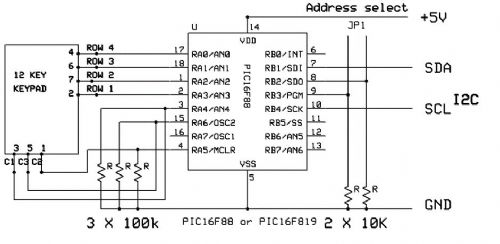

Hi
Here is a 12 key ascii output i2c keypad. It is an easy way to get manual entry data into an i2c based system.
Hex data files for f88 and f819 are in the zip file. Also a roughish PCB layout. I only use expresspcb and can provide layouts in that format if need be. As I have said with the other i2c modules, my aim is at the hobby constructor who can do up a vero board module. Driving instructions are also in the zip.
2012-12-13_104601_12_key_keypad_i2c_.zip

Pete, did you want me to see if I can adapt the membrane keypad to my hex key i2c picf88? (or rather adapt the firmware)
d.m
