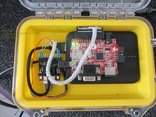

I have now completed the enclosure work for my 5 Hz GPS logger
It contains
1. Outboard GARMIN GPS 5 Hz
2. RS232 to TTL converter
3. DuinoMite Mini running MMBasic
4. 16 GB Class 10 MicroSD Card
5. Belkin USB 5 V back pack 2000 mAH
6. Saves to file very minute
7. Cuts daily files.
- Andrew -

Can you tell me what Garmin GPS you are using and what did you have to do to get it to give you 5Hz output?

Pretty easy
01. GARMIN GPS18 5 Hz - be carefull its 5 volts !
02. A little RS232 to TTL converter off ebay
03. The GPS gets 5 volts from the IDC connector.
04. The GPS TTL is connected to COM1 on the IDC connector
05. The GPS is 19200 N 8 1
06. I have connected TX RX VCC and GND on the GPS
07. On startup I can send the GPS $PGRMO commands to set the NMEA data
08. Once a minute the daily file is closed and re-opened.
09. 16 GB Class 10 MicroSD card
Please look on the IDC pin layouts I have posted before.
Running MMBasic 4.03B
