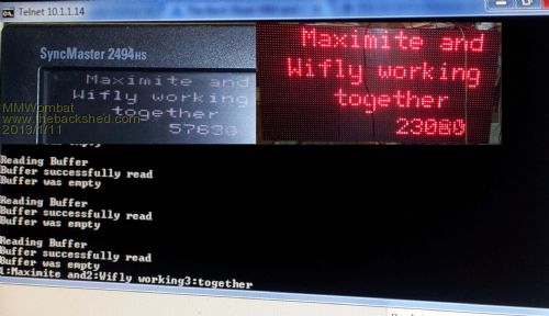

Here is a picture of telnet window with two pictures in picture. One of the MM vga output, the other is output on 9 panels (3x3)...final would be 21 panels 3 wide by 7 high
regards Dennis

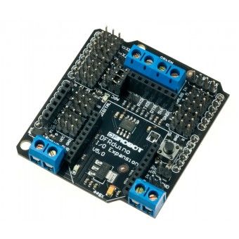

You can plug it into this shield.
The RN-XV is pin compatible with the XBee modules so any shield that supports XBee should support the RN-XV.
These are available everywhere including DFROBOT.com and EBAY.
