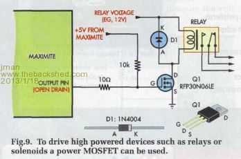

You sure do need a transistor or mosfet
That is from the original Maximite article

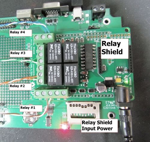

Here for reference is a relay shield on a CGCOLORMAX1.

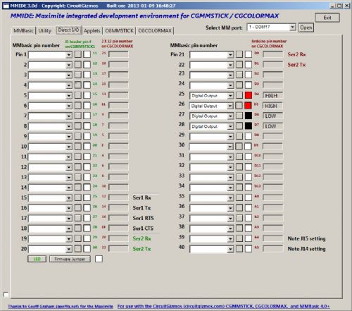

And controlling the relay with MMIDE 3.
