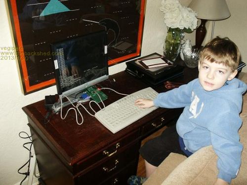

I've attached a picture of my 4 year old son working on the CGColorMax. At first I thought he was writing a web browser for it but when I looked more closely, I saw he was just typing random garbage. But you never know. He has though learned to type 'RUN' <ENTER> to get a program to run. Pretty good. I think I was driving before I learned that.
