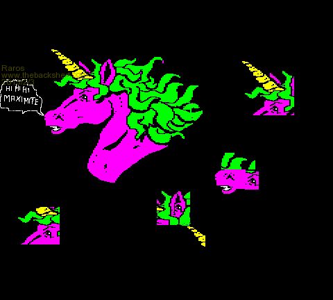

For fun i did this graphics program, Micro MMPaint for Maximite Color using a serial mouse.
View post: http://www.thebackshed.com/forum/forum_posts.asp?TID=5499&PN =2
(Hey Geoff I'm sorry for the image is not offensive!)
Is not yet complete!

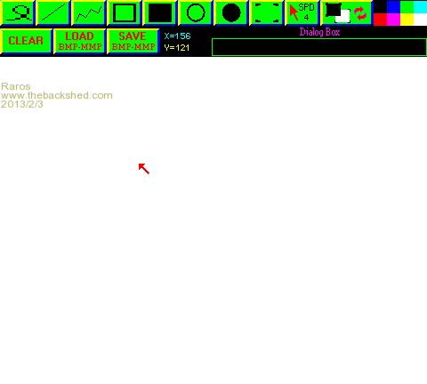

The menu button is fairly intuitive.
Button top-left: Free design (default).
Line and multi-line in mode sequentially.
Boxes and boxes filled.
Circle and filled circle.
BLIT copy portions of the screen with preview.
Mouse speed.
Swap the color of the Foreground and Background.
Choosing the color of the Foreground.
The second set of buttons is:
Clear screen with the background set.
Load and Save BMP.

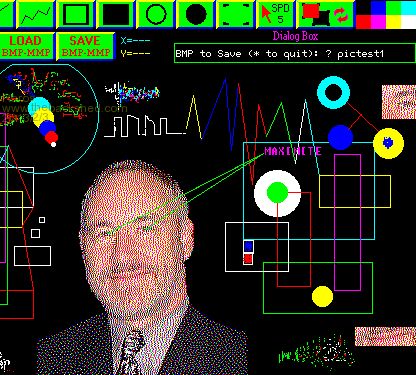

View post: http://www.thebackshed.com/forum/forum_posts.asp?TID=5523&PN =2
With Load BMP can be specified with the mouse the coordinates of loading.
The X and Y coordinates
Finally, the 'Dialog Box' indicates the operations to be done.
At any time you can abort any command by clicking anywhere on the menu.
