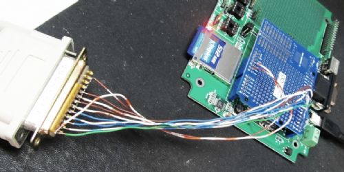

I was cleaning out my work area and up on one of the shelves was a Panasonic printer. So just for fun, I made a printer interface for the CGCOLORMAX2. Wiring only took a few minutes, as did writing the code.
Here is the hardware:
Here is the prntfile.bas code:

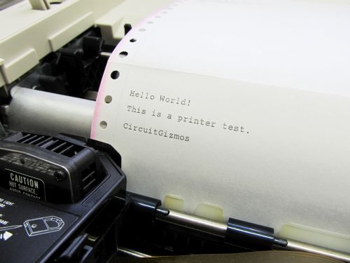

Here is the text file:
Hello World!
This is a printer test.
CircuitGizmos
Here is the result:
Ah, to hear dot-matrix again!

Can you please post the circuit?
I see you have a yellow thing soldered to the LPT plug - I am guessing this is a resistor network in the area of 10k or so as pull-ups on the data lines?

  Grogster said   Can you please post the circuit?
Yes. That is a 10k resistor pack. Pulls pins 1-9 on the 25-pin connector up to 5V. Pin 1 is the printer data valid line - when pulsed low the printer accepts the ASCII data value on pins 2-9.

Hi Rob,
Just curious, Why did you use Open Collector outputs? If you set as digital outputs (x,8) you may be able to do away with the Resistor pack...
Or is it to do with the +5V printer input and the respack is pulled to +5V to provide a solid High? I suspect this is the case. I think +5 is present on pin 36 of the centronics plug anyway...
Good work Rob,
I used 5V logic to be sure that it would work with this printer. Centronics +5V isn't supposed to be used for anything, according to the printer manual.
This is just an example "how-to" I did mainly because I had the printer. I'm not defining any particular pins as Maximite printer interface pins. The printer interface has more than just the 8 data and one signal line - I made this as minimum as possible. There is, for instance, a 'ready' line that would be used to let the Maximite know that the printer is ready for more data.
