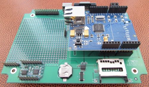

There are network shields available for the CGCOLORMAX2. I have not done anything with the one I have.

Yeah I have seen them. But having a look at the Aurduino 'include' Ethernet library makes me think it would be fairly processor heavy just to monitor and respond to network traffic. If this were a core responsibility of the program then it would work. The Netburner Module should allow me to store and serve pages and does the data collection for me... just exposing variables which I could act on with a simple serial interrupt.
