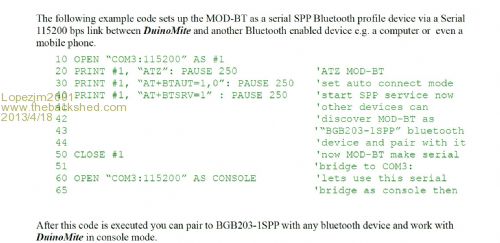

I have ordered and received a MOD-BT (Uext bluetooth device) to use with my Duinomite Mega from Dontronics. I run the following basic program below and it seems to work but my MOD-BT is not being discovered. I only see the LED on for a second when I plug in me MOD-BT but at no other time does the LED light up. Does the LED of the MOD-BT suppose to light up at any other time other than when being powered up?
When I run it the MOD-BT cannot be discovered by either my computer or Ipad1 which have discovered each other but not my MOD-BT. I did a google search and I found this
