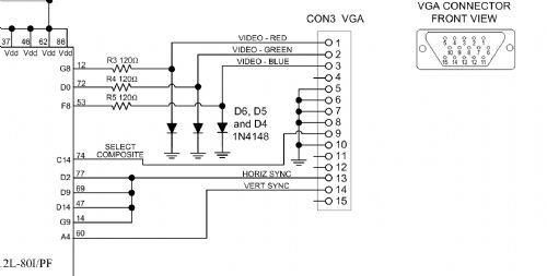

Here is the VGA part of the circuit diagram for an ORIGINAL CMM.
If the text is there but very dim then I suspect that either the 3 x 120R resistors might have been stuffed with too high a value..
Use the schematic and a multi meter to buzz out the circuit if you can.

Try another VGA monito first though, maybe the backlight on the monitor has decided to keel over.

One other area you might look at - the original CMM had a pretty frail VGA connector which could easily be bent up and in my case, due in large part to my own clumsiness, I broke off a number of the tracks between the connector and the motherboard.
Using Mick's circuit, try to buzz out the connection between the tracks on the motherboard and the actual pins in the VGA connector.
