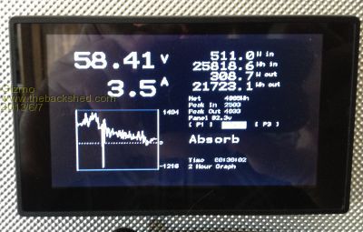

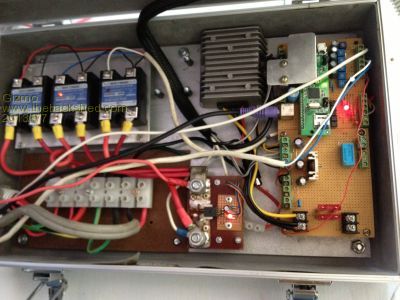

I'm using a Maximite clone to control my solar array for my off grid power system. The maximite monitors battery voltage and current, and switches 3 solid state relays. The solar panels are grouped so that by switching the relays in a certain way I can step up the power in 6 steps, sort of like a binary counter. This is used to regulate the voltage for the charging cycles, eg boost at 60 volts for a couple of minutes, absorb at 57 volts for 3 hours, float, etc.
The other day while I was welding, the output current readings on the display went over 100 amps and caused a error, due to MMBasic trying to format a number longer than it expected. This caused the program to exit, at a time when all 3 relays were switched on, meaning the batteries were fed full power from the solar panels. Lucky I noticed it within a few minutes, and restarted the program. Later I fixed the bug in my code to stop it happening again.
