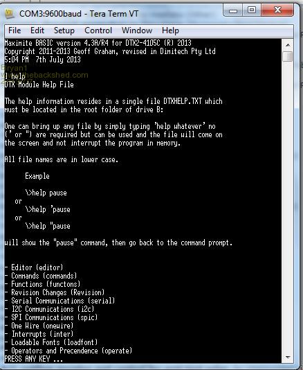

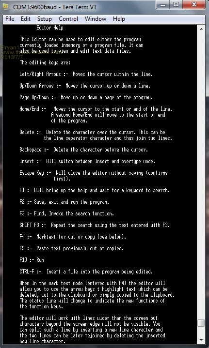

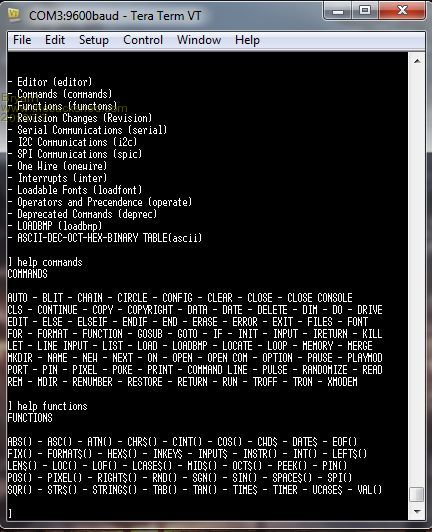

Hi Guy's,
Here's a few pic's of the Help system as viewed in TeraTerm
The Main Help Screen
The Commands and Functions (Still more to add)
The Editor Help Page (not noted as yet is the ability to create files)
Regards Bryan
