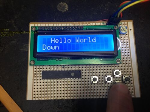

Hi
I saw this Adafruit LCD with buttons and built one for my PI
The interesting thing these LCDs are RGB backlit
Then decided to port it to the Maximite
This PCB has an odd layout connecting the LCD to the 23017
Would have been much simpler if it used a logical layout ie 0-3 for d4-d7
instead it uses 4-1 for d4-d7
The cool thing is you get an LCD and 5 input switches with just 2 pins as it uses
I2C. The I2C is handled by a Microchip MCP23017.
Attached the basic code to make it go.
This is based on the LCD code from the Library
2013-07-07_065707_MCP23017.zip

  elproducts said   Thanks for sharing jman.
Just having MMBasic code to communicate with an MCP23017 is helpful.
You are welcome
