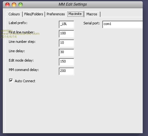

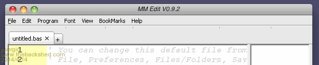

psergiu
Joined: 09/02/2013
Posts: 83
Posted: 12:56pm 14 Apr 2014
I installed TerraTerm, it can "talk" to the Duinomite-Mega but there's a strange ~1sec delay from my typing until i get a feedback on the screen.
Tried at 9600 and 57600, same delay
I'm using the Windows version. There's no Linux emulation for OS X as far as i know.
I can resize the settings window in MMEdit2 by the lower-right corner - there's no GUI decoration for that corner and the mouse cursor does not change - i guess that's Wine's fault.
The toolbar is there, when i mouse over the button locations i see a little "raise" animation for a 3-4 pixel high area. I clicked one in the left side and i got the "Save" window.
MMEdit2 zip file is unpacked in c:\Program Files\MMedit2, the Data dir is in there.

Posts: 6625
Posted: 01:18pm 14 Apr 2014
That's good information.
I had trouble with TeraTerm (and MMEdit) getting the serial ports to work well.
I had similar delays to those you are seeing. (I don't know much about Wine)
It looks like CrossOver doesn't return the size of my toolbar. It is good that it is there even if it's too small to use.
I can add a check to add a default size if the true size is not returned.
