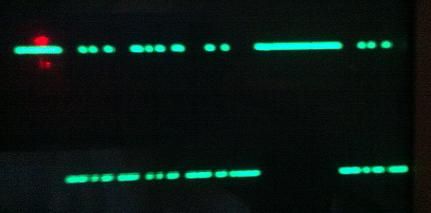

10 open "com2:19200" as #1
20 print #1, 0
30 pause 3
40 goto 20
CGColorMaximite (similar on DuinoMite Mega)
The long highs are the pause time.
Shouldn't the rest be mostly just low ?

Remember that you are sending asc("0") followed by CRLF
That's in decimal 48,13,10
And probably a leading space as well

It's supposed to be the number "0" as in zero ( 8 low bits )
Maybe I have a complete misunderstanding somewheres ?

You probably want CHR$(0) then.

Try
... print #1, chr$(0);
Note the semi-colon as well (to suppress the CRLF)

Thanks Guys ! ..... :)
That does it .
