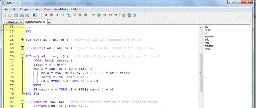

I have made some progress with the all new Windows/Linux version of MM Edit.
It has multiple tabs, code folding, function list (that's the box on the right), fully configurable colours, and colour printing.
It is taking a while to learn the differences between Windows and Linux and I really should be doing other things around the house...

Maybe I wasn't clear enough.
The current download is a small update to MM Edit. The only new(ish) bit is the ability to make a portable installation.
The code folding etc is in an entirely rewritten version of MMEdit which is still very much in Beta stage.
To get Linux, I have had to learn a new programming language as well as learn about GUIs in Linux. My previous experience with Linux has been command line only so there is a lot to learn.
I hope to have a version for you all to play with in a few weeks.
One useful (I think) addition will be the ability to drag multiple files onto the edit window.
