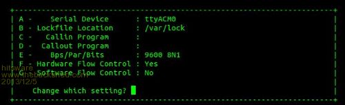

The PC sees the Duino (ttyACM0) but I get no screen and an error
(on terminal) 'can't open ttyACM0'
What should be settings on serial setup ?

1)installed Minicom via dpkg
no errors shown
2)followed this (from Duinomite users manual)
(except installed minicom via usbdrive with
dpkg since I have no internet on target PC):
LINUX:
If you use Linux the DuinoMite drivers will be
automatically recognized and installed.
Open console and install minicom terminal program.
$ sudo apt-get install minicom
Then you should locate which virtual communication
port is DuinoMite by running this command:.
$ dmesg | grep tty
You will see cdc_acm driver something like:
[103473.694556] cdc_acm 5-1:1.0: ttyACM0: USB ACM device
Please remember ttyACM0: as you have to setup minicom to use it:
$ minicom -s
Setup the serial port to ttyACM0: and you will see the greet message:
MaxiMite BASIC Version x.xx
Copyright 2011, Geoff Graham
Olimex Port By kenseglerdesigns.com
Everything seems right except no 'greet message'
instead 'cannot open ttyACM0' message
Edited by hitsware 2013-12-06

That helped .... got 'permission denied'
If I use
sudo minicom -s
then save the settings as 'duinomite'
(I wasn't saving before)
it works ... I guess 'sudo' supercedes
the needed 'permissions'?
So now how do I use 'duinomite' to not
have to go through the whole setup each
session ?
