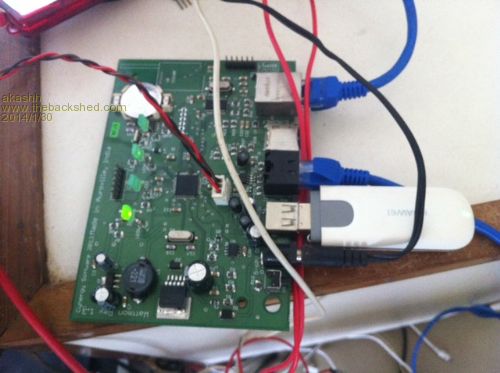

Here is a picture of the Wattmon board with USB dongle plugged in an connected to the Internet.
The RTC and battery backup keeps track of time. The HV power supply can be seen at one end. microSD, modbus port (RJ45), Ethernet and USB are all along one edge.

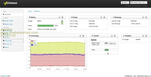

Here's a screen shot of the latest web interface dashboard running on Wattmon.
Sorry, for some reason it is very small, and when I link the large one, it changes the format of the page too much, so here's a link if you are interested:
Link to bigger image
