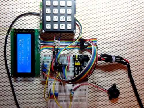

It works fine that way Rob. I'm doing that on UV lamp exposure controller now I'm working on now - code below. I just set it to 99 and loop till "keypress" returns as other than 99. I also got it to assign the 99 to another variable and convert it to a string but that's unnecessary - I just haven't changed it from some playing I was doing.
The 24 pin Pic's looking a bit cluttered too you might notice, but it's handling the standard 4x4 keypad and 4x20 LCD display fine. There's also a pin being used for a lamp relay and one for a buzzer - there's still a couple left!
You can't see it on the photo but that cursor is flashing nicely and steps through the mins/secs entry as it's done and does entry error checking too. The empty line under it has the "Countdown" on it when the lamps are ON - all very well lined up now that Geoff's given us the STR$ function with optional leading zeroes - great!
The code works fine as is but it would never pass "Programming 101" . There are a heap of "naughties" in it yet that I'd like to get rid of.
Greg

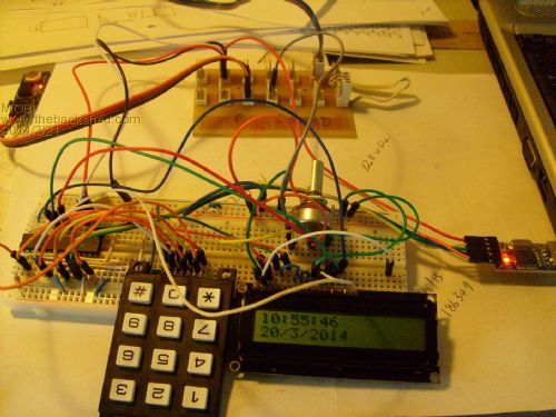

My version allows a RTC register to be selected by a 2 digit decimal number, then input a 2 digit BCD value and if the # key is pressed,(accept), the routine writes the BCD value to the register. Simple! This allows alarm values to be set as well.
David M.
MOBI
Joined: 02/12/2012
Posts: 819
Posted: 02:55pm 20 Mar 2014

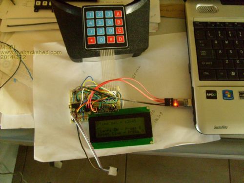

This version lets you select any RTC register and alter its value via uMite Keypad. The aim was to use uMite keypad and LCD. Frankly, I'd prefer i2c LCD unless using the 44 pin Pic as not too many I/O pins are left for outside world control.
It doesn't have "time-out" facilities but that wouldn't be hard to include. As it stands, it is little more than a clock but once again, individual applications are easily enough programmed in. The main part is the ability to select and change individual registers.

Thanks David, that's going to be handy for another project where I need real-time.
My "timer" is purely that, just entry of minutes and seconds, turn ON, countdown, turn OFF - break countdown if wanted. Good for up to 99 minutes (or more if program is modded) and with one second accuracy. No real-time involved.
I've tidied up the code a bit (below) but if anyone wants to show me how to do it much more neatly I'm all ears. It's working OK but there's a couple of bugs. For some reason I have to press the 'D' key three times to return to MENU and the 'B' key twice to start the countdown after having already counted down the first time. I also get a "Not in interrupt" error occasionally which bombs it out. Any ideas gratefully appreciated. Here's the "tidied" code.
Greg

  Greg said  I've tidied up the code a bit (below) but if anyone wants to show me how to do it much more neatly I'm all ears. It's working OK but there's a couple of bugs. For some reason I have to press the 'D' key three times to return to MENU and the 'B' key twice to start the countdown after having already counted down the first time. I also get a "Not in interrupt" error occasionally which bombs it out. Any ideas gratefully appreciated. Here's the "tidied" code.
I printed off your timer code and have been trying to work through it. (Is it a PCB exposure timer?)
It looks to me like too much is being done in interrupt routines. I had my knuckles wrapped by Geoff (and rightly so) earlier wrt keypad interrupts.
I wonder if there are time constraints on uM interrupts. Geoff did say not to hang around too long in an interrupt which is why I wrote the keypad interrupt routine as simply Kp_Int: IReturn and use the variable KeyCode in the main (or sub) routine.
You shouldn't have to press the Keypad keys more than once to get a response. It sounds like a timer interrupt or similar is blocking the keypad interrupt. Just wondering. I need to examine your code in more depth. Unfortuantely, the wind is blowing quite hard directly from the wind turbines, and thinking is not easy at the moment.
David M.

Joined: 07/10/2011
Posted: 02:43am 21 Mar 2014
Yes it's for a collimated UV lamp box to expose resist coated PCB's - I'm hoping to get good enough resolution to do the 40 pin 0.4mm pitch pads for the flex connector socket for the 5" TFT Maximite screens - time will tell!
It could be the length of the SETTICK interrupt routine but that's only called once a second. The problem is it's also looping waiting for any STOP keypad presses in the meantime while it's counting the seconds down.
I'll keep chasing it but I want to get onto doing the box - I've got all the bits here now.
Greg

  Greg said  Yes it's for a collimated UV lamp box to expose resist coated PCB's - I'm hoping to get good enough resolution to do the 40 pin 0.4mm pitch pads for the flex connector socket for the 5" TFT Maximite screens - time will tell!
You should be able to get good resolution for your etching. I guess you are using the Kinsten photo resist boards. Just using mono laser print and lightly oiled post printing, I got good fine tracks for the PIC32 100 pin TQFP. I used UV LEDS for the light but I believe ordinary fluoros work just as well.
I'll rehash my bread board and replace the 12 keys with a hex pad and 20x4 LCD instead of the 16X2. I can easily dump your programme in so you can use me as a sounding board. It makes following someone else's programme easier if you have the same hardware set up.
David M.
paceman
Joined: 07/10/2011
Posted: 04:52pm 21 Mar 2014
Yes I'm using the Kinsten coated boards. Whether I'll be able to get good enough resolution to do a decent job of the 0.4mm pitch of the 40 pin flex connector, I'm not sure. The 100 pin TQFP chip of the Colour Maximite has 0.5mm pitch so it's not quite as tight but certainly getting down there.
Thanks for the offer to duplicate things, we should be able to sort it out properly. The pin numbers I'm using are on the previous listing - you could add an LED onto pins 14 & 21 to see the other outputs (again, on the listing). I'd think a timer keypad/LCD combination would be a common requirement for a lot of control projects so it should be useful for others too. Geoff's direct Basic commands to control them have certainly made things easier.
Greg

paceman
Joined: 07/10/2011
Posted: 07:17pm 21 Mar 2014
Well unless you need to use the 28 pin DIP chip, the 44 pin chip is an easy alternative, pretty much the same price and easier to source. It's lead spacing isn't too bad either at 0.8mm, assuming you're happy to use SMD's - but these days you need to be able to use SMD's and in some ways they're easier - no drilling. There are still four pins available on the 28 pin DIP anyway so you could still add I2C peripherals with them.
To keep the keypad connections to the breadboard a bit neater, I peeled two sets of four leads off one of those 40pin terminated ribbon cables (male/female terminations). You can plug four at a time too - if you keep the pins consecutive If you use a single eight it's not flexible enough. On the keypad end I soldered an eight pin, right-angle header - pins underneath and facing back in. The female lead-ends connect there and it makes it easy to connect/disconnect to change projects. There are four standoffs holding it above the desk.
The soldering is going to be interesting. It'll certainly be a flood-and-then-wick job I'd say, and if I get any bridges persisting - well I'll face that when it happens we're in this for fun anyway aren't we!
For the artwork I'll start with transparencies and see how it goes - I've got some of that green Pulsar TRF foil that I might have a go at densifying the toner with too.
Greg

Posted: 09:45pm 21 Mar 2014
@ Greg,
As you can see, I got the jungle running - not pretty but it works.
I got your programme in and yes, it does do a few quirky things and hangs up/ bombs out etc.
I had never heard of the TRF foil. It look like the cat's whisker for fine PCB traces. Pity my laser mono is a Brother and the toner will not iron onto blank PCB no how. Never mind, Kinsten, NaOH developer, and HCl H2O2 etchant works for me - no "big bangs" here so far.
Now, on to the programme...
David M.

MOBI
Joined: 02/12/2012
Posts: 819
Posted: 12:13pm 22 Mar 2014
  Greg said  Oh come on David, be kind. My description would be "generally works OK" but has a couple of quirks
Sorry, It does sound a bit harsh. Actually, I think your programme is "nearly there" and I do like the neat way you enter the minutes and seconds.
  Quote  Do you know exactly what concentrations of HCl and H2O2 your etchant ingredients were before mixing - and the mixing ratio and supplier. If you do it'd be worth mentioning that in the other thread.
The HCl is 30%(same as builders use for cleaning concrete) and the H2O2 is 3% (off the shelf from the supermarket).
I think Downwind did an article on TBS on making PCBs and may have included the concentration and mixing ratio. If I can't find it on TBS, I have it in an obscure folder on the PC somewhere.
I checked my archives and the ratio is two parts H2O2 to one part HCl. (add the HCl to the H2O2)
