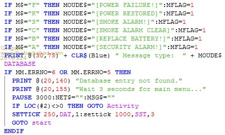

Just an update - when I loaded up MMEdit2 version 0.9, ALL the colour syntax is correct - the user-defined subs(normally black) are correctly capitalized in purple, and the syntax after the LOC command is also correct.

...I note that one of the SETTICK commands is still black, but the LOC and user defined subs are correct.

The cause of the second SETTICK not highlighting is the ':'
Multi-statement lines were a problem but I think you will be pleased when I get around to releasing the next beta.
