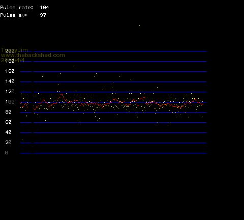

I had an ECG a few days ago and the good news is - my first attempt at programming the monitor was correct after all!
The bad news is the same - my Maximite monitor is right - my heart beat IS all over the place.
For the technically minded, I now have Atrial fibrillation.

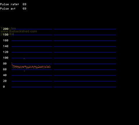

The code charts pulse rate (in yellow) and a running average of the last 12 pulses (in red). The running average was needed because of the erratic nature of my pulse.

The first screen dump is from a 'normal' heart rate while the second one is mine.
It would be fair to say that the maximite has saved my life!
