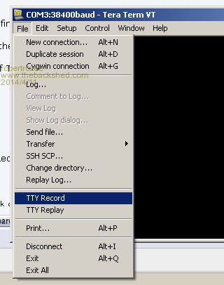

Posted: 03:22pm 10 Apr 2014
here is where to find the menu item - i'm using windows XP:
but i do have a sinking feeling that the extra 'garbage' is timestamping info embedded in the log file so that it plays back in real time. could be a case of 'finger trouble' on my behalf - perhaps i should have been using 'Log...' instead.

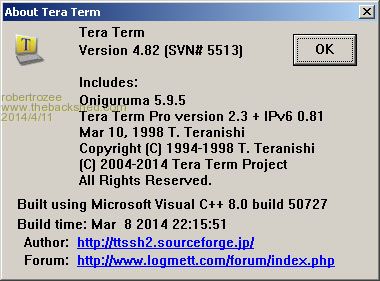

interesting - perhaps there are multiple compiles available out there?
here is a snapshot of the 'about' screen from mine:
nonetheless, it does sound like 'TTY Record' and 'TT Replay' are intended for something quite different from what i had assumed. many thanks to those who helped solve this one. in future i shall use the 'Log...' option instead!
