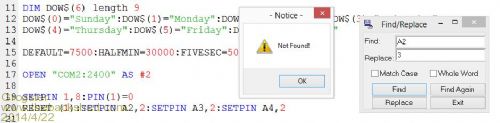

This is for the old MMEdit, version 3.4.4
After two find/replace procedures, it won't see the third one:
Note how on line 20 of the code, it should be seeing A2 there...
If I close MMEdit, then restart, it then works for the next two cycles.(a 'cycle' in my terms, is finding/replacing right to the end of the code)
Closing the find/replace window, then selecting it again results in the same problem, but if I actually CLOSE MMEdit totally, and restart it, the find/replace works again.
I only came across this, as I had to change my pin assignments to make room for something else, so I used the find/replace, to save me having to hunt the code for each and every one I wanted to change.
EDIT: JPG resizing is making it really hard to post a clear image - please let me know if you can't read it, and I will link to external site such as Imageshack. I think you can just make it out though.....Edited by Grogster 2014-04-23

I was unable to recreate the error.
Could you PM me with some code that fails for you for me to play with.
I am using V3.4.8 but I didn't make any changes to the search routines in the recent updates.
