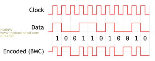

I built a cassette tape system as mentioned by greybeard very many years ago. I think that it used signals somewhat similar to below.
Bi-Phase Mark Encoding although it sounds complicated is a relatively simple method for data transmission. It is easy to generate and decode and is used in many applications including the method used to record a Timecode onto professional video and audio recordings, or for recording data on discs and S/PDIF. A very big attribute of this modulation is that a data clock can be derived from the signal. It does not matter if the signal is inverted and it is “non return to zero”, therefore capable of passing easily through analog signal equipment, for Timecode with audio amplifiers and recorders.
Using a timer tick for generation of the signal with MMBasic should be OK with a Micromite, and requires little external hardware, just a capacitor to couple the signal if from a Micromite pin to an analog transmitter.
As shown from this diagram the encoder output changes polarity at each positive clock edge, but it also changes polarity at the negative clock edge IF THE DATA IS a 1.
There is a requirement that there be a few zeros in any frame to enable the detector to lock. It works well if the signal is continuous or a burst of repetitive transmissions. A 3 KHz clock will give a signal that will pass through a telephone quality audio pass band, through a simple radio system. A Micromite may cut this speed.
To decode the data the received analog “Audio” signal must be squared up or “sliced” back into a digital signal. This requires a comparator (LM311 $1.65). Then an edge generator to create short pulses on both the rising and falling input edges (one quad nand gate 74HC00 or 4011 $0.95) that will trigger a monostable (LM555 or 4047 $1.25) whose period is about three quarters of the data rate, plus a data latch (4027 $0.95) and a few resistors and small capacitors. Possibly the monostable (timing or delay) and latch functions can be performed using a Micromite digital input with an edge interrupt starting a time delay, OK for slow data rates. The trailing edge of the monostable becomes the decoded data clock. Data is detected as a 1 if there is an edge pulse detected while the monostable is still high. Due to zeros within the signal code the monostable will lock to the correct edges to decode correctly. I will draw a circuit and timing diagram if anyone is interested and have specified here CMOS for low voltage operation but would prefer HC types at 5 volts.
Unique data patterns used when only a small number of control codes must be communicated will easily be detected when shifted into a register, perhaps a Micromite text string can be shifted and compared. If more complex data is involved then generation and detection of unique data headers must be used to designate the beginning of data frames. For instance for Timecode the header was “0011111111111101”, which pattern did not occur in the data and also indicated if the data was being received forward or backwards, i.e. spooling forward or back.

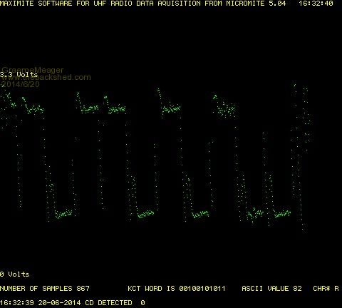

So I have given the Kansas City Tape Interface protocol a bit of a go. Have got some results.......
Here is a screen shot of the demodulated sampled word generated by the micromite, transmitted over the UHF radio and analysed by the maximite.
The bits are fairly well defined and although it is not very scientific, I am using this code to decifer the bits:
Sub GETWORD 'READ AVERAGE OF 5 SAMPLES FOR EACH BIT AND CONVERT TO BINARY
For WW=20 To 800 Step 75
AVSMPL=(KCTWORD(WW)+KCTWORD(WW+1)+KCTWORD(WW+2)+KCTWORD(WW+3 )+KCTWORD(WW+4))/5
If AVSMPL >1.50 Then KCTBIT$="0" Else KCTBIT$="1"
KCTWORD$=KCTWORD$+KCTBIT$
Next WW
Print @(180,400)"KCT WORD IS ";KCTWORD$
I am aware that I will have variations in signal strength and timing so I was wondering if anyone could advise on more accurate methods of coding.

You have made good progress!
I still intend to play with the IR commands, reduced in frequency to suit audio. When I have time, that is...
Over FM, the signal strength does not affect the amplitude of the audio. It is only when the signal strength is low and there is noise on the audio that you may have problems.
It looks like there is a bit of overshoot so a small capacitor across the audio might help.
Another way of decoding is to look for the start transition then wait until you are in the middle of the timing cycle to do a read. I will have to read up on the Kansas City protocol.

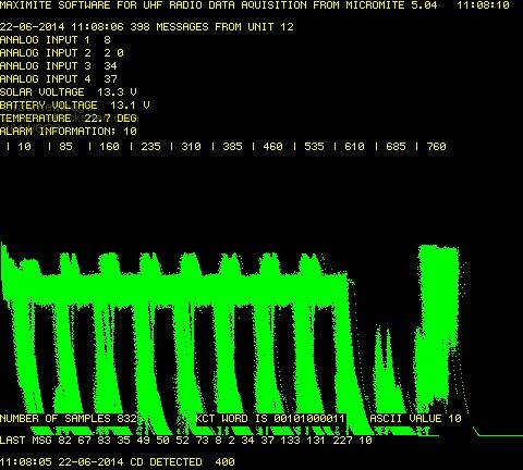

  Quote  It looks like there is a bit of overshoot so a small capacitor across the audio might help.
I have been using a 180p cap as it gave the best compromise of waveform shape and symmetry.
I did a long term test using the format and got near 100% error free over 400 packets. The horizontal scale shows the relative sample points across the data bits.
The first bit is short as I am relying on the CD line to set the interrupt and there is a time delay for this to happen. By default for KCTS the first bit must always be a 0.
Not sure why but there was a bit of drift in the amplitude/magnitude of the audio output. I have managed to overcome this by using the first sample as the voltage reference for the maximum height of the waveform.
