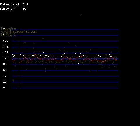

Example for April:
The yellow dots are the instantaneous readings and the red is the average over 12 pulses.

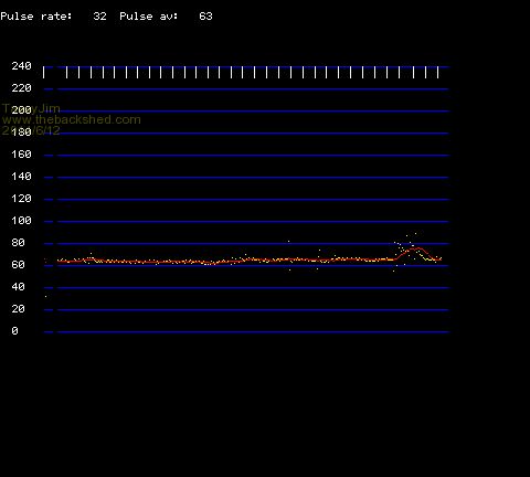

Today's trace:
The blip at the end is when I reached down for the keyboard.
Yesterday's trace was more like the first one so whatever happened to fix it, happened last night.
