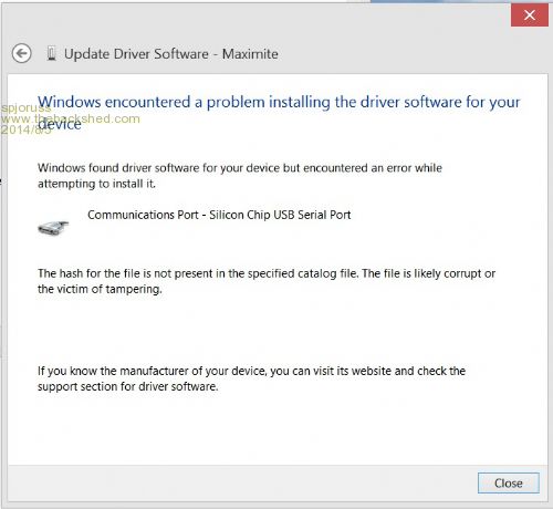

I am trying to install the USB driver for the Colormax2. When I do I get an error. It says a hash file is not present in the catalog file. I tried the driver from geoffg.net and from CircuitGizmos with the same results. I attached this screenshot of the exact error message. Any idea what I should do?
I am running Windows 8.1
Thanks,

This issue has been covered before, but check out this link:
Windows 8 unsigned driver install

Yes, I also run Win 8.1, and had EXACTLY the same error. The link that Bob Devries posted is the way to fix it. A lot of hoop-jumping for something so simple as a USB driver install, but there you go....
The fix does work, as I have my SC driver all working fine on my Win 8.1, so just follow your nose. Probably a good idea to print out that page though, so you can follow it, as many of the steps require the full-screen Metro GUI, so you can't(easily) go back to the web page to read the next step.

Thanks BobDevries and Grogster. That works fine. I can use the MMIDE with it now.
I have a windows 7 64 bit machine also. I got it working on it too by using the instructions that came with the driver. I also had to change the com port in the MMIDE to the one that the Colormax2 is operating on.

Bob's solution is only for 64 bit machines. I have the problem on 32 bit.
