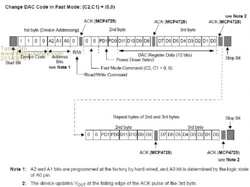

You beat me to it. I had a MCP4725 but had to wire it up to test. '*** I2C MCP4725 ***
MCP4725_addr = &B1100010 ' MCP4725 address with A0 = 0, A1 = 1 A2 = 0 ' A0 is set by the enduser, A1 and A2 are factory set I2C open 100, 1000 ' Enable I2C do for n = 0 to 4095 step 10 hibyte=n \ 256 lobyte=n mod 256 print hibyte, lobyte I2C write MCP4725_addr, 0, 2, hibyte,lobyte Pause 5000 next n loop A VERY slow ramp with the 5000mS delay. The data sheet is typically confusing.
The 'fast mode' is the simplest to start with and PD1/PD0 can stay at zero. That should keep most of us happy. You do need to know how the address bits were set in the factory. In my case A1 is set and A2 is zero. Trial and error will sort it out if needed. @Grogster, We are sending bytes with I2C so 255 is the maximum you can send. Jim VK7JH MMedit |
