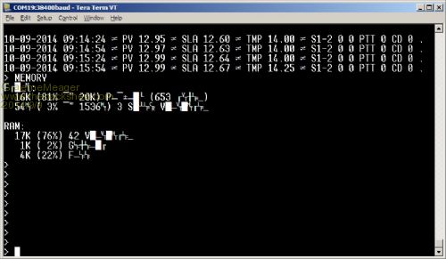

If I leave Teraterm running for a couple of days some of the characters end up screwy. The characters seem to gather another bit or something but it doesn't seem to effect the numbers.
Can anyone throw some light on a cause? (happens on different PC's and different micromites)

It looks like some of the ASCII characters have the 8th bit set or some other translation.
Can you provide a copy of the text (not a screen shot)
TeraTerm can handle a lot of different encoding schemes other than plain ASCII so anything could have happened.

If I close down TeraTerm and restart it the corruption does clear. Interestingly the code above is cut and paste from what was shown on screen with corruption.

I suspect that there is a sequence of characters that tricks TeraTerm into thinking it needs to use a 'strange' font/encoding.
The only time I have seen that is when I tried to display an XMODEM transfer.
There is probably a setting in TeraTerm that will stop it happening (but I don't know which setting!)
Next time try "Control / Reset Terminal" instead of restarting.

from page 49 of the VT100 manual on geoff's website:
G0 Sets G1 Sets
Sequence Sequence Meaning
ESC ( A ESC ) A United Kingdom Set
ESC ( B ESC ) B ASCII Set
ESC ( 0 ESC ) 0 Special Graphics
ESC ( 1 ESC ) 1 Alternate Character ROM
Standard Character Set
ESC ( 2 ESC ) 2 Alternate Character ROM
Special Graphics
the following micromite code produces the results in the teraterm window you are seeing:
Print Chr$(27);"(0";
Memory
Input a$
Print Chr$(27);"(A";
rob :-)

Thanks Robert, Looks like I would only need to exclude Chr$(27) from printing to the console.
