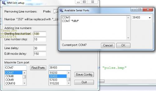

Go to File/ Configure Maximite.
Select 'Find Ports'
and see what is listed.
Some devices such as the original Maximite will have a *MM* to indicate it is (probably) a Maximite and other USB-serial converters will be listed without the *MM*
You may need to close all but the edit window before plugging the USB device in or Windows can get confused.
>Select 'Find Ports'
I did that :
>>MMEdit finds the SparkFun unit ...... (Maximite Connected Com7)
>>but not the VT100 ................... (Maximite Disconnected)
There's some subtlety missing. Maybe with the VT100 I.D. ?
Even if the VT100 terminal appears differently to Windows, MMEdit shouldn't care.
MMEdit is supposed to find ANY serial port. It is only if it is determined to be a Maximite that the *MM* appears but that doesn't matter, the serial port should still appear in the list and work OK.
As you know the port number, what happens if you just select that port without doing a search?
I don't have a chip suitable to use the VT100 code so I am unable to guess what is not working.
I can understand if the 'load and run' command wasn't working but a simple connect with chat doesn't care about versions of 'mite etc.
