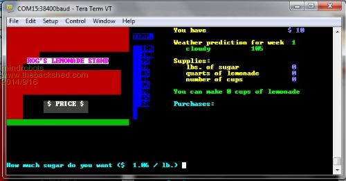

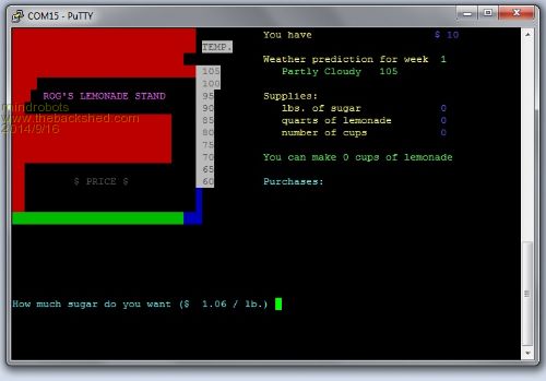

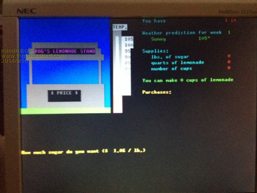

Just so you don't think Jeff and I are totally daft (insert regionally appropriate slang),
A VT100 isn't a VT100 isn't a VT100 - so beware if you are making fancy VT100 screens. As the poets often say, "Beauty is in the interpretation of the escape sequences!"
This is what you see running lemon.bas on a Micromite connected to Terra Term:
This is what you see running lemon.bas on a Micromite connected to puTTY:
...and This is what WE see running lemon.bas on one of Propeller Powered's MMCs:
All the same MMBASIC code, just different implementations of the VT100 control characters.
Glad that VT100 thing is a standard!
Share screen shots of your favorite VT100 emulation playing lemon.bas!

Wow.. I didn't have a chance to test that program on the terminals; only the MMC.
What a difference! I'm pretty sure that my COLOR routines (these are the one's that are at issue) at written to the VT100 spec.
Either we've set the bar really high with the MMC, or TerraTerm and Putty are a big disappointment when it comes to VT100. Nah.. Couldn't be.. I'll review the VT100 specs tonight when I get off work and see if we can improve things for terminal users.
Jeff
