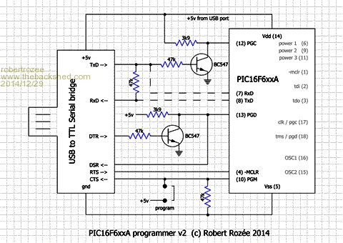

fyi, i have been in touch with Nigel Goodwin about the possibility of him releasing the source of WinPicProg for further development by others. i believe it is written in delphi 6, and i have a copy of delphi 5 that i could use for continuing development.
so far i have received a reply from Nigel, and am now awaiting his views on my request. as the regulars may have guessed, my interest is in adding support for LV programming using this hardware programmer design:
rob :-)

Thanks for the info. but I prefer to use the HV programming.
